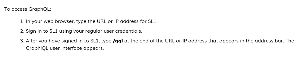

Hi Tom. Are you trying to log on and log off using the user interface (SL1)? The log on steps are here:
We can add a step to return to SL1 by deleting /gql from the URL. Then you can log out of SL1 to close out of everything.

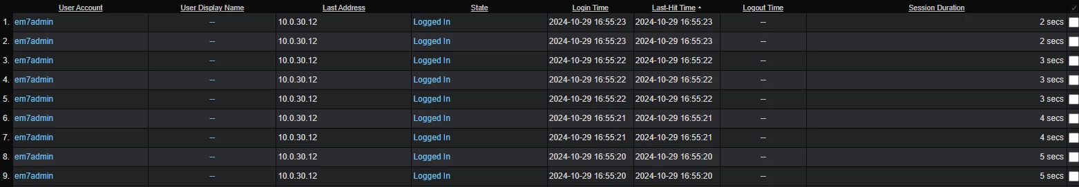

I don't mind using basic authentication, however if I run a script which needs to do several iterations (eg. get all cpu data from all 200 windows servers in batches of 10), I have created 20 sessions, which stay active until they expire (in our case in 8 hours).
I just verified this by trying to run a simple gql "{ account (id:"_self") { id user }}" 10 times ==> I get 10 separate sessions and they all stay there:
The main reason I use the /authenticate option is to ensure all subsequent calls are done with the same session, as I have seen scenario's where an interface no longer worked because of too many active sessions for that user...
