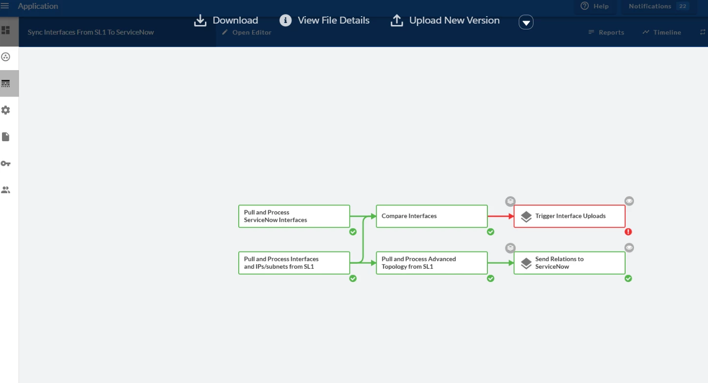

I have a failed powerflow, how do I see the actuall error

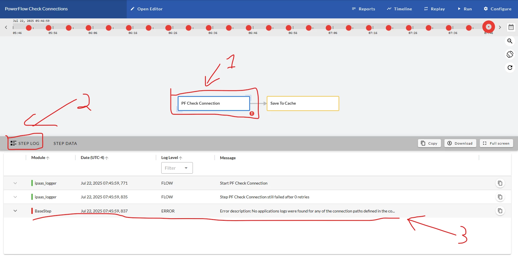

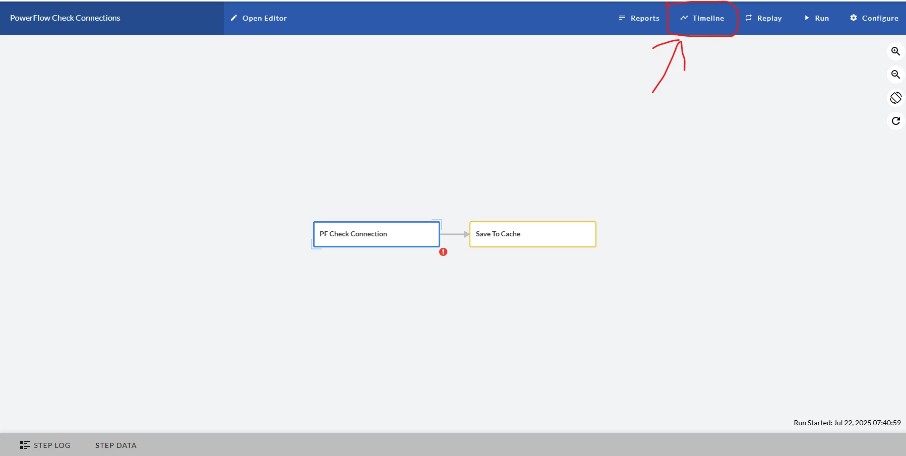

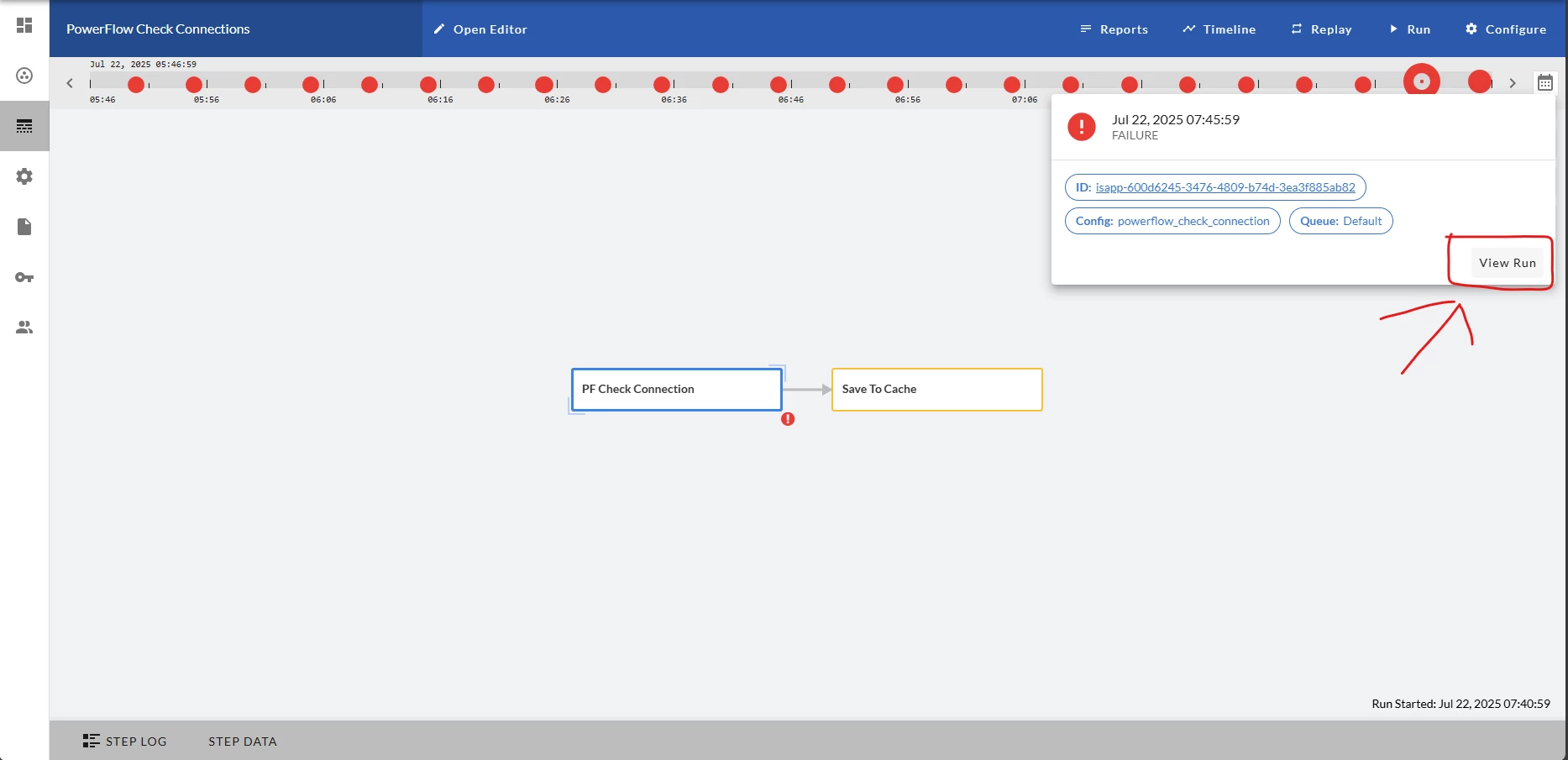

These are the steps I am referring to. First, click on the Timeline button.
Then, hover over one of the red dots and click the View Run button.
Finally, click on the step that failed, click on the Step Log button and you will be able to see the specific error in the drop down menu.
I hope this clears up my original response.

Hello Rob,
In the page for the application with the error, click the Timeline button and click the latest red dot for the most recent run with a failure and click the View Run button.
Once the run loads, click on the step that failed and then click on the Step Log button. This should load the logs for this step in the application and show you where it failed and any associated error logs or messages.

  • Jul 21, 2025 1:28 PM UTC
hmmm I hto get a red dot to show up (it actually looked like a TARGET logo) ad to run it in info mode ill upload the json out put
