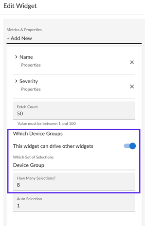

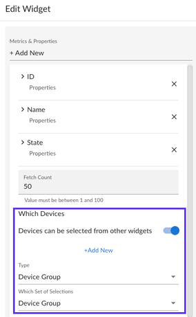

A device group widget configured for This widget can drive other widgets, should certainly be capable of driving a device widget configured with Devices can be selected from other widgets set to context Type of "Device Group".
Device Group widget setting context:
Device widget consuming:
While this quickly depicts a simple device widget with table visualization, the selected metrics and properties shouldn't matter. Can you confirm you're utilizing a similar configuration? If not, or if you do not mind sharing, can you provide details as to how you currently have your two widgets configured and the behavioral result you're getting?
