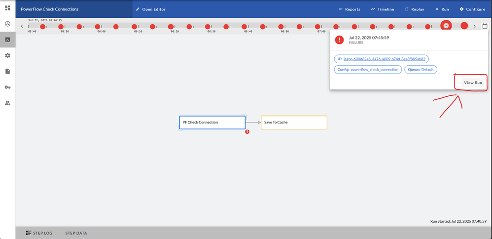

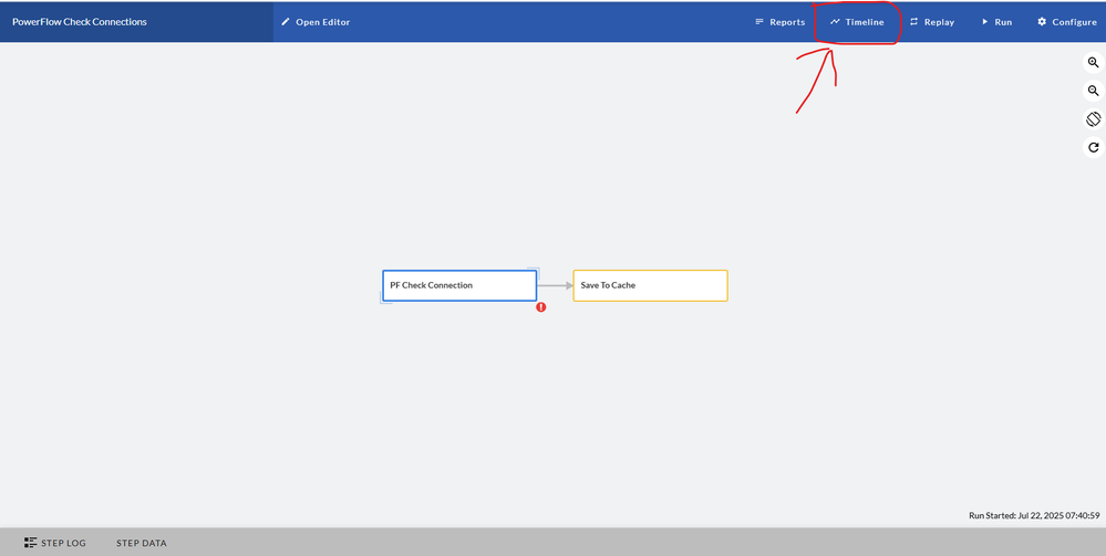

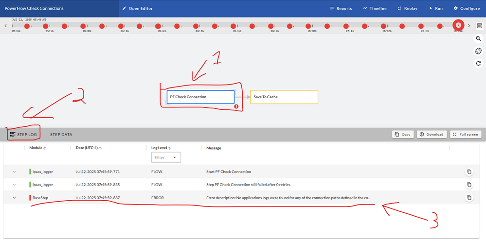

  • Hello Rob,
    These are the steps I am referring to. First, click on the Timeline button.
    Then, hover over one of the red dots and click the View Run button.
    Finally, click on the step that failed, click on the Step Log button and you will be able to see the specific error in the drop down menu.
    I hope this clears up my original response.

  • Hello Rob,
    In the page for the application with the error, click the Timeline button and click the latest red dot for the most recent run with a failure and click the View Run button.
    Once the run loads, click on the step that failed and then click on the Step Log button. This should load the logs for this step in the application and show you where it failed and any associated error logs or messages.
    Antonio Andres
  • merrittr's avatar
    merrittr
    Icon for Contributor II rankContributor II
    hmmm I hto get a red dot to show up (it actually looked like a TARGET logo) ad to run it in info mode ill upload the json out put
  • merrittr's avatar
    merrittr
    ok gotcha yes it looks like it is timing out connecting to an external api

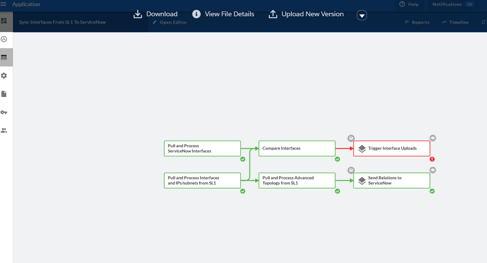

  • merrittr's avatar
    merrittr
    "filename": "BaseStep.py",
    "level_name": "INFO",
    "level_num": 20,
    "line_num": 571,
    "message": "Executing: Trigger Interface Uploads - steps/TriggerApplication.py",
    "module": "BaseStep",
    "timestamp": "2025-07-21 11:24:22,048"

    • TonyAndres's avatar
      TonyAndres
      Hello Rob,
      Antonio Andres
      • merrittr's avatar
        merrittr
        yeah that is great , so this seems to e timing out making an API call into service name , how do I edit this powerflow to see what the URL endpoint is
