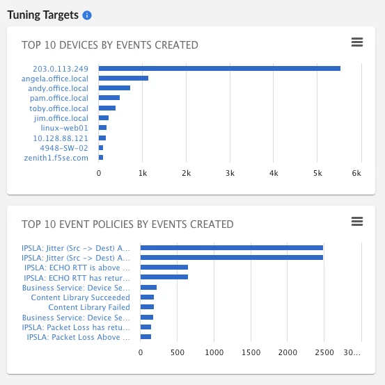

1. Use Event Insights
You probably know that Event Insights (Expand left menu -> Events -> Event Insights) is a powerful view to see how SL1 is reducing noise in your system, but did you know that it helps you see potential optimizations also?
On the right side of the Event Insights page there is a section called “Tuning Targets”. By looking at what devices are creating the most events and which event policies are resulting in the most events, you can see actions that you can take to clean things up.
In the example screenshot above, I would want to look at device 203.0.113.249 to see what is going on to trigger so many events. It could be a misconfiguration on the system, a hardware issue that needs to be remedied, or a threshold that could be tweaked. The lower section shows event policies that are being triggered the most. Noise-reduction options here include requiring multiple triggers within a time frame to be sure that the events are persisting, suppressing the events for test or dev devices, or tweaking thresholds to be sure that the event reflects an actionable problem to fix.

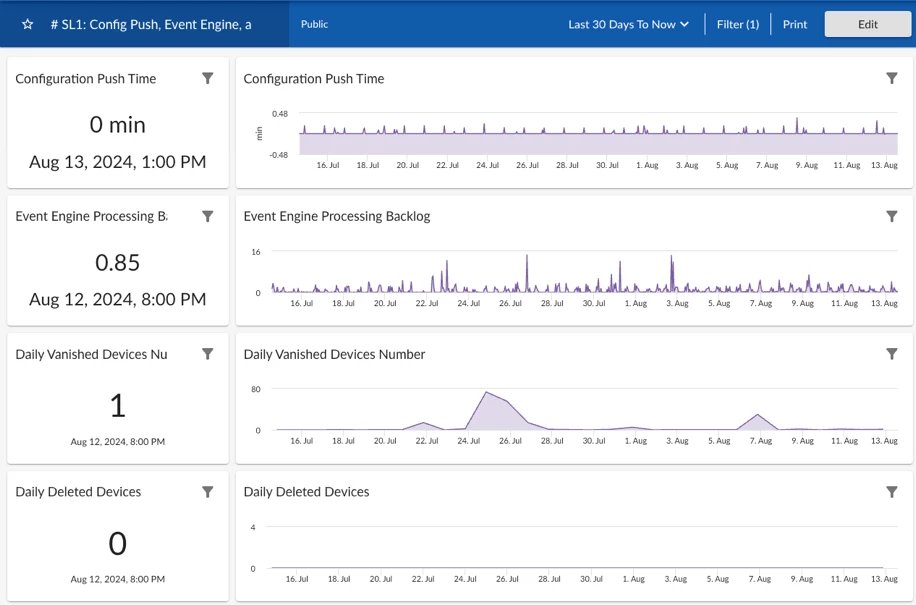

2. Use Operational Insights
Operational Insights is a powerpack built by ScienceLogic to help manage your SL1 stack. There are separate versions for self-hosted and SaaS customers, but most of the functionality is the same. Once it’s installed and configured, it presents data on a series of dashboards. These dashboards can help you see the status of your collectors, keep track of the trends in the number of devices discovered and business services configured, and even keep an eye on under-the-hood metrics like Configuration Push time and the Event processing backlog.
